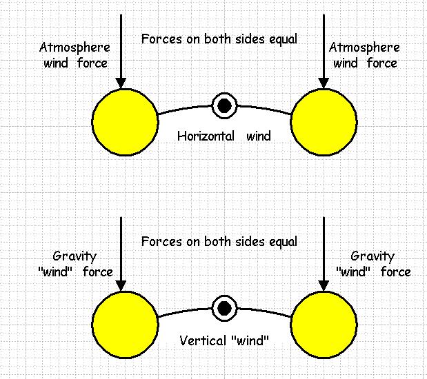

As the first stage of an answer consider the following.

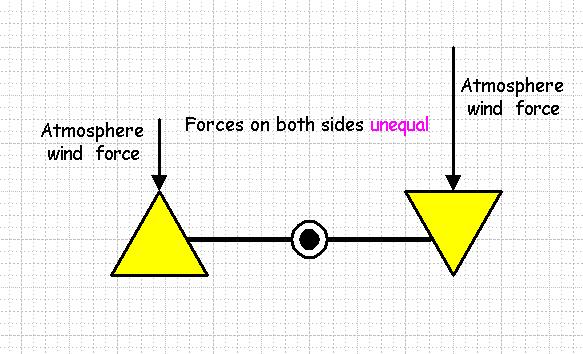

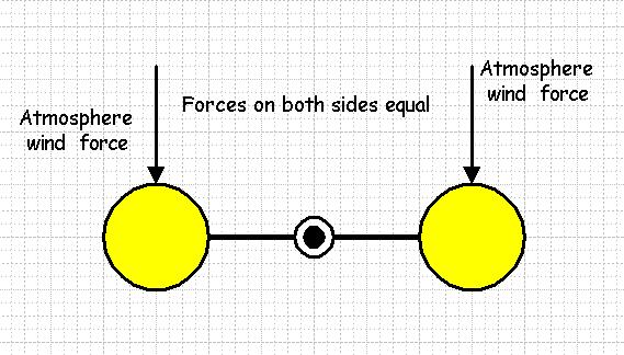

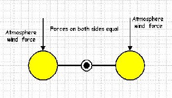

A footballer picks a ball out of the back of his net and pushes it 20 feet against a fierce wind which is blowing straight towards his goal. When he's taken it 20 feet towards the other goal and given it 20 feet of wind field potential energy he lets it go. It picks up speed and accelerates towards the back of his net. So, 20 feet of potential energy gained and 20 feet of potential energy lost.
He then gets two footballs and puts them at the end of two arms with a vertical axle in the middle which is dug into the pitch.
The wind force on each ball is the same but the balls don't move backwards to the net because the force on one balances the force on the other and the total force is grounded by the axle.
He then alters the shape of the ball so that it is a cone.
The device now resembles a two arm anemometer . It spins merrily driving a miniature generator.
I ask the same question as you asked:
"where did any extra Energy enter the picture & from whence did it come?"

Grimer wrote:I ask the same question as you asked:
The answer to your question, using your example Grimer, is this.
The Ke of a mass m kg's moving at v meters per second = 1/2mv^2 joules.
Therefore the Ke of 1m^3 [cubic meter] or air is 1/2pv^2 joules. N.B. p = air density.
And, if all of this became pressure, the pressure increase will be 1/2pv^2 newtons per m^2.
Or, if the frontal area presented to the wind is s square meters, the total force on the object will be 1/2pv^2 newtons.
But, the resistance formula is ...
R is proportional to psv^2 ... or ..... R = Kpsv^2
N.B. differing Coefficients are required, depending on shape of object in air flow, to adjust the math theory to fit the experimental evidence because a coefficient of 0.5 [1/2] only works for flat plates.
One of the reasons for a coefficient adjustment to reflect true pressure & force [newtons] is because the math assumes that fluids are NOT viscous, when in fact they are.
So, K should theoretically be 1/2 but for all shapes it varies [so that the force experienced matches the math theory].
What this is saying is that not having viscosity accounted for in fluids [air is a fluid] means that the math does not allow for vortices to form behind the object, which accounts for the increase or decrease in K values [coefficients] - also the math assumes that the air molecules all strike an object & don't flow around at the edges & also that the collisions are all totally inelastic i.e. there is no rebounding of molecules.
So the energy density of the moving air is the same both sides of the axle - but one side has a different Resistance Rating with a different coefficient.
In a nut shell, one side has less resistance force than the other.
So, NO extra Energy entered the picture !

Fletcher wrote:So, NO extra Energy entered the picture !
Absolutely right. Image
The problem is not finding extra energy. The problem is organising the oodles of energy that is already there.
Look, for, example how the wind & gravity fields bend the arms of the dumbbell beam.
We have to find a way to reduce the "negative" widdershins energy and increase the "positive" clockwise energy.
As Bing put it:
http://www.youtube.com/watch?v=-cgVRwIT ... re=related
Now the anemometer does this by changing shape.
We do it by changing inertia. Moving a weight from a high inertia wheel to a low inertia wheel involves a gain in inertial entropy. The weight represents a higher proportion of the total inertia for the low inertia wheel than it does for the high inertia wheel.
