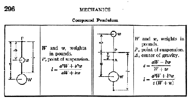

Just to clarify...
The first portion of both of our formula's are the same: I = (m1 × r1^2 ) + (m2 × r2^2 )
Or can be written alternately as: I = (m1 × r1 × r1 ) + (m2 × r2 ×r2 )
But then Dwayne’s formula is: RofG = √ ( I ÷ (m1 + m2 ) )
While Jim’s Machinery’s Handbook formula is: RofG = I ÷ (m1 × r1 ) + (m2 × r2 )
They give similar but slightly different results.
This will take a little sleuthing to find out why the difference.
I might add that Machinery's Handbook was originally written a hundred years ago. At that time calculating the square root of a number by hand was very cumbersome. Sometimes alternate formula were devised that would give similar but not exact results. This could have been be the case here.

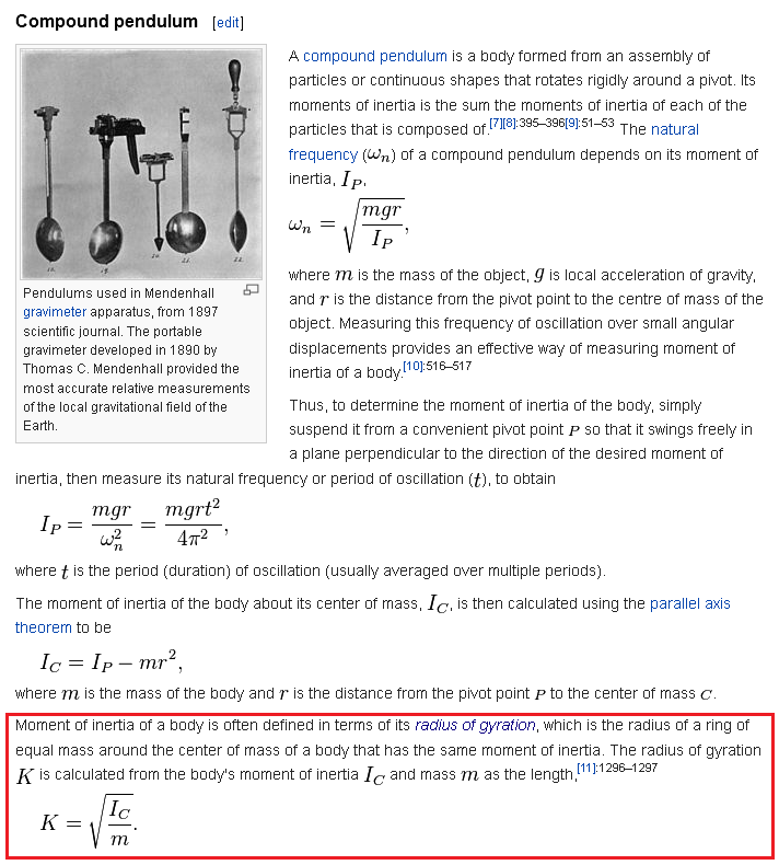

Yes, I agree with your first statement. The relative proportions certainly do make a difference.
In regards to the other, I got my number from what I understand to be the very definition of the radius of gyration and when using that in your method it seems to be in total agreement with all the other methods for solving the problem as you can see below.
I honestly don't know what the deal is with your handbook formula, but it seems to give a value that is too large.
I believe you will find that computer simulations will bear this out.
The following number for the kinetic energy is what we would DEFINITELY have in the given problem when the rotation reaches 50 RPM.
Kinetic energy of two 1 kg masses rotating at 50 RPM at a 1 meter radius plus the kinetic energy of the 0.5 kg drive mass moving at 1/10th their speed downward:
KE = 1/2 * 2 kg * ( 2 * pi * 1 meter *50 RPM /60 (seconds/minute) )^2 + 1/2 * 0.5 kg * (2 * pi * 1 meter *50 RPM /60 (seconds/minute)/ 10 )^2
KE = 27.5 joules
Now, if we use my calculated value of the radius of gyration for the complete system we can calculate the kinetic energy thusly.
Kinetic energy of the total 2.5 Kg rotating at 50 RPM at a 0.896 meter radius of gyration:
KE = 1/2 * 2.5 kg * ( 2 * pi * 0.896 meter * 50 RPM / 60 (seconds/meter))^2
KE = 27.5 joules
So, the radius of gyration that I calculated gives the correct energy value and so then also the correct time and other stuff with your method.
You really can't dispute that this should be the kinetic energy value, either, because when we were told the geometry of the problem and the final rate of revolution - this kinetic energy value became a given.
I don't know what else to say. If you have different numbers - and a different energy value - then you have to try to explain where that energy is.
This is where I stand. Your method appears to work if the actual radius of gyration calculation is correct - but your handbook formula doesn't seem to give it.

What I suspected is indeed the case.Furcurequs wrote:jim_mich
It seems to me that the the "l" given by your handbook formula may not be the radius of gyration about the pivot point at all but rather the length of the "equivalent simple pendulum" as is discussed here:
http://blog.cencophysics.com/2009/08/compound-pendulum/
They do appear to be different values.
Take care.
Dwayne
Here is the formula that Jim used:
Link to Machinery Handbook at Google Books
...and here we find the explanation as to what the "l" is as described on the previous page in this edition of the Machinery Handbook:
Here are the relevant sentences:
So, this means that the formula Jim used in his calculations does not give the radius of gyration but rather the length of the equivalent simple pendulum for a compound pendulum - and for the purpose of more easily determining the period of oscillation of the compound pendulum using the already familiar formula for calculating the period of a simple pendulum.The center of oscillation is the point at which, if all the matter in the compound pendulum were concentrated there, it would make a simple pendulum which would oscillate in the same periods of time.
In the formulas in the tables: l = the length of simple pendulum or distance between point of suspension and center of oscillation...
I posted this because some may still erroneously believe - like jim apparently believed - that he actually used the right formula from his handbook. That was not the case.
The actual formula for the radius of gyration of a two point mass system is simple to calculate and you really shouldn't need a handbook. One just adds the moments of inertia of the two point masses at their given radii and then divides that number by the total mass and then takes the square root of all of that.
So, in summary, had jim_mich used the correct formula for the radius of gyration in his calculations, his method would have indeed worked and given the same answer as we obtained using all the other methods.

Back in post post #121111 I explained why my answer was 25.5367 seconds, while all other peoples answers were between 21.358 and 21.4 seconds. I'll quote again:
And Wikipedia explains that Moment of Inertia is often defined in terms of Radius of Gyration...
In order to ACCURATELY determine the EXACT performance of any rotating or swinging object, one needs to know not only the radii to the center of the objects, but also the shape of the objects, and of course the mass of the objects.
In the above post, Dwayne failed to show the Radius of Gyration definition that is in Machinery's Handbook a few pages before the pendulum example.Jim_Mich, in [url=http://www.besslerwheel.com/forum/viewtopic.php?p=118976#118976]post number 118976[/url], wrote:The discrepancy is that with my calculations the weight masses out on the ends of the rod are fixed to the rods and thus are rotated, whereas the weights of WM2D were allowed to free-wheel and thus not rotate. Fixing the weights to the ends of the rods rather than letting them free-wheel results in it taking a slightly longer time to accelerate up to speed. In this case about 4.17 seconds longer.

That is exactly what I did! But I went one step further to gain a little more accuracy.The actual formula for the radius of gyration of a two point mass system is simple to calculate and you really shouldn't need a handbook. One just adds the moments of inertia of the two point masses at their given radii and then divides that number by the total mass and then takes the square root of all of that.
