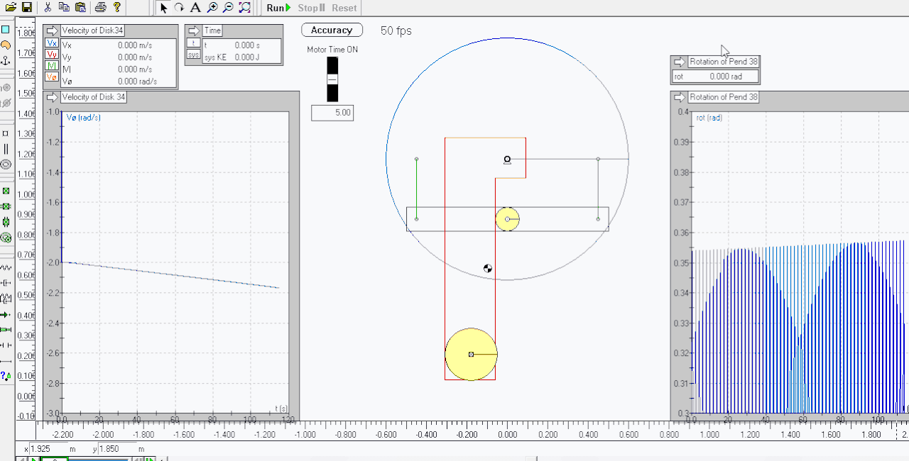

Mornin Rox .. I see that you and RH are rationalizing the sims and nutting out what they mean i.e. making progress in interpreting the outputs reliably ..Roxaway59 wrote:There are a few things that strike me about this Fletcher so I wanted to mention some of them.
We have talked many times about resonance, oscillations and positive feedback loops. You have mentioned something about negating the back torque.
It seems to me that this has the possibility of all those things.
Also we have talked about the possibility of the simulations giving an indication of the right approach. This could be that indication.
Its unusual in my opinion for both WM2D and Algodoo to agree on anything.
I first got some positive results in WM2D and I then moved over to Algodoo.
At first I couldn’t get Algodoo to work. I then realised that some of the beams weren’t of a similar weight. On changing the weights it began to work similar to WM2D.
I’m getting the feeling that there is something here.
I just hope that feeling is right.
** One other thing I would like to add is that I believe that it is not tuned correctly. It needs to be optimized not just for one mechanism but for several crossbars working together. All the crossbars have to work in harmony with one another or they will work against one another.
Disclaimer .. it gives me no pleasure at all in always being the bearer of bad tidings - being the damp squib and potentially stifling invention, discussion of ideas, and enterprise - that is not my intent nor character - that being said, feedback is important to advance our collective and individual thinking and strategies - to logically and rationally work our way towards a final bullet proof proposal for a gravity PM wheel that maintains its imbalance factor so that it accelerates and is self-moving .. if we don't examine and critique with honesty, and learn from it, we are doomed to be stuck in ground-hog day .. the point imo is to learn from it, eliminate, and move-on ..
FWIW, I think "We" are on the right wave-length/path - we need an oscillating system that has a positive feedback - and that is primarily gained imo from a unique mechanical regenerating imbalance factor i.e. net positive torque to accelerate the wheel - as I often describe it, having a bona-fide asymmetric torque that feeds the continuing and growing CoG imbalance, aided and abetted by an oscillating driver analogue ..
So, onto your sims for discussion ..
I'll just cut to the chase as you and RH have basically got there ..

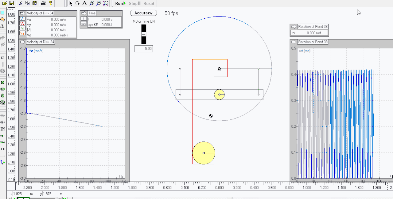

Background .. My approach with an unusual result is to always firstly simplify by reducing down and taking out unnecessary complexity - I did this with your WM sim as you can see in the animation gifs - for the benefit of the other community members reading your thread the background wheel/disk is connected to a hanging pendulum arrangement - the disk is set in rotation by a motor at -2 rad/sec ( about -20 rpm ) - I changed the motor ON time down from 10 secs to 5 or less seconds - the hanging circulating pendulum interacts with the pivoted "L" shaped hanging pendulum in a feedback situation .. the idea is that the feedback oscillations should build up once the motor is switched OFF - and the sims predict that this is indeed happening - so I added and tweaked and refined some outputs to better show the trends for those less familiar ..
Part of "stress-testing" a sim is to look to the obvious and the not-so-obvious before deciding it is reliable ..

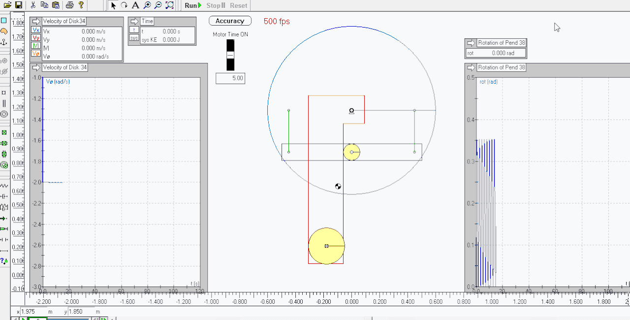

So the obvious thing to do is to adjust the accuracy setting from 50 fps ( in increments of 50's ) and the rising of wheel rpm continues until about 250 fps when it is reduced significantly ( at 500 fps there is no excitation gain in rpm ) .. this suggests to me that there is a potential iteration problem at lower accuracies as the 2 pendulum systems interact i.e. at 50 fps the steps are too large possibly spitting objects apart with energy ( been discussed many times ) ..
The not so obvious is to dumb-it-down even further with a double-check - so I made the 2 pendulums in feedback interaction "do not collide" - and guess what ?! - at 50 fps the wheel rpm still grew ( potential bug at 50 fps ) - increasing the fps this didn't happen any longer .. BUT, the hanging "L pendulum" did NOT increase in amplitude at the same time, indicating there is a sim problem !
Animations and sim available below ..
My conclusions .. the increase in wheel rpm from the interactive feedback mechanism is likely to be not real - because the imbalance factors are not asymmetric imo .. however, I am convinced "we", who follow this line of logic, are in the right ballpark and are refining the approach daily .. keep the focus, and the thinking going ..
ETA .. Georg ( mentioned earlier a few pages back ) also was on this oscillating feedback path, but had no way to mechanically maintain the imbalance asymmetry fwiw ..
- Bessler work out 4 Forum2.wm2d
- Simplified
- (16 KiB) Downloaded 253 times

Hi Fletcher I don’t think that you are the bearer of bad news or anything like that. You are expertly pointing out that the simulations are doing something that we would rather they didn’t do.
Simulators are a double edged sword and they can save us time on the one hand but waste time on the other.
Generally they are a good thing and are very useful but have to be used with caution and due diligence. To a certain degree I have found this out the hard way.
If I am honest I was half expecting that you would find what you did because it is becoming a familiar pattern with these simulators.

Hi Fletcher I was thinking about what you have said about the simulators giving a false positive.
I'm the kind of person who try's to see the real issues clearly in my mind. I don't always succeed but I try to do it anyway.
On this issue of false positives I'm viewing it like a rounding off error. Like when you take Pi and round it off. The figure you end up with cant be a hundred percent accurate.
There are two things that strike me about this.
1) The scenarios of a non working wheel that works because of a rounding error and a working wheel that works because it doesn't have a rounding error (high accuracy) should be very different as the accuracy increases.
2) Because we are dealing with false positives at low accuracy it must also mean that a working wheel will not necessarily work on low accuracy. Therefore that would be an argument against starting on low accuracy.
The question must also be asked what level of accuracy is sufficient?
