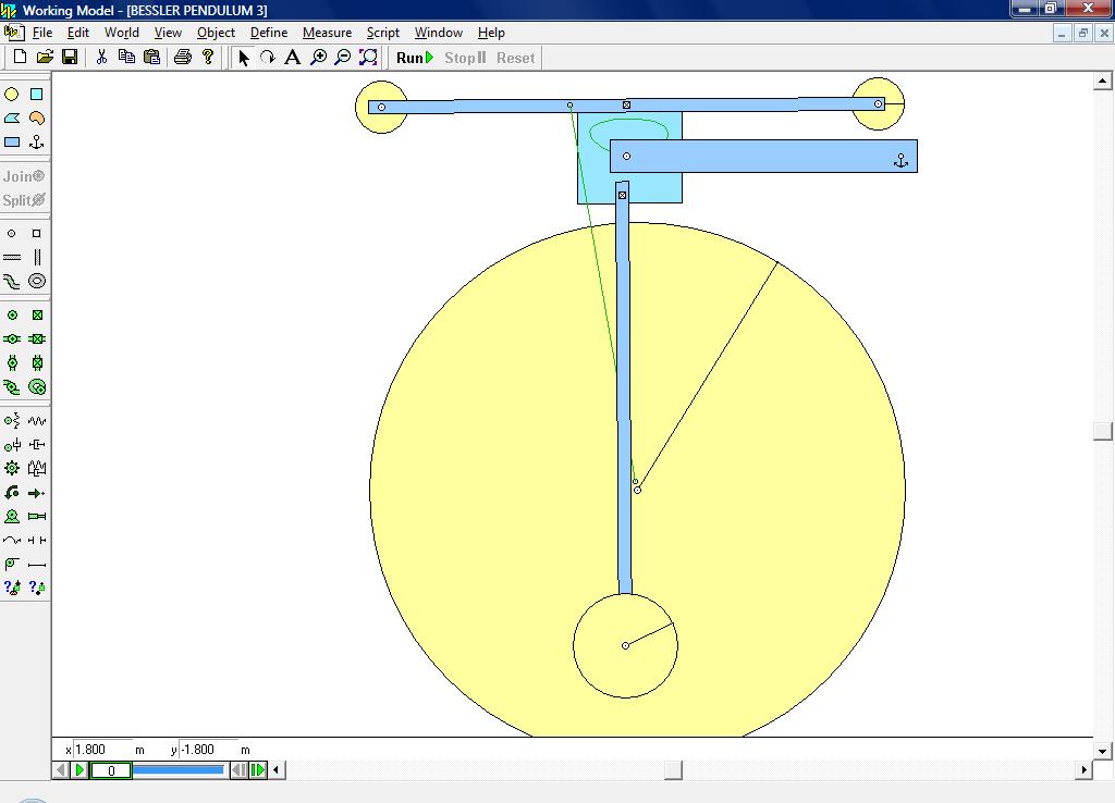

Welcome mindsweeper,
Thanks for the demo but many here can't access WM2D so what I do is add a screenshot of the design as well.
This oval slider is fascinating to watch but I wouldn't add any credence to it.
Attached is another design based on Bessler's loose pendulum design. This also includes an oval slider but it is set on the pendulum pivot.
It illustrates a working wheel but I doubt if it would work in reality.
Kas

Hi KAS, Thanks for the welcome, it's nice to be here.
Kas, I ask you why you dismiss my model so quickly, comparing it with a wheel that acts as it should only to reverse and slow down at frame 3700 ish. If you rum my model from load it ramps up. Runs all the way to 30,000+ frames gathering momentum.
Is it to be dismissed so quickly?

re: Interesting Design
G'day Dave,
Welcome to this forum. I have been playing a little with your design and I am beginning to harbour the suspicion that you have struck yet another bug in WM2D
Have a look at this.
Hans von Lieven
Hans, you changed the mass of the bob to 0.010 and it's position is now push and not pull, it can only fail.
I'm sorry to say, but your simulation is invalid.
I know now what you have done. When you first started the programme you got an error message something like object x is overlapping object b do you wish to continue?
Evidently you pressed yes and this is when the whole thing went haywire. WM2D cannot handle 3 dimensional arrangements and that is what you have here. One of the smaller wheels is overlapping the large wheel at the startup.
After you override the programme's objections to this it goes haywire. I missed it first time through because it gives you the warning only once. It wasn't until I copied your arrangement into a new file when it showed up.
Sorry
Hans von Lieven
ooh, that does not happen with when I run it, and never has.
I can also recreate the model and it runs every time I make it. Even with slight alterations to the masses and positions which show in the measurements.
So to be honest I'm losing faith in WM2D. The only real way is to spend and build.
You are correct, WM2D can be a good guide if the models are simple but the ultimate test is a prototype.
There are a lot of bugs in WM2D. I have a whole collection of perpetual motion machines that run in WM2D. Here is one of them put together by Stefan Hartmann.
Hans von Lieven
Yes Hans, I did see that, and it's still a sticky on the forum..
I don't see any overlap error Hans. When you copy and paste in working model the new objects revert to your default collision setting, which in your case I presume was 'collide'.
mindsweeper - your accuracy settings are far too low - try setting animation step to 100/s. In WM2D I've seen many a perpetuum mobile at low accuracy settings become a perpetuum stabile at higher settings!
