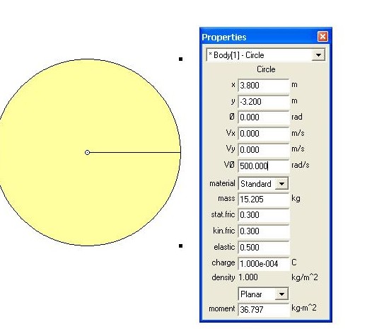

Hi Jim, I have a question about giving a wheel an initial "push" to get it moving.
If you look at the screenshot you will see that I have entered "500" in the velocity "rad/sec" box.
Is this just applied as an initial starting velocity or is it applied constantly as a continual force?
Probably a dumb question for someone who has been using the program for a couple of years.
Thankyou.

That's one way to give the wheel an intial starting velocity. If the wheel has components attached they will get jerked around at the begining since the program will think that the wheel is already turning and the components are sitting still.
The method I like to use is to add a torque force (or a motor) that gives the wheel torque until a preset time has elapsed. This would be more like Bessler's wheel being given that intial push.
