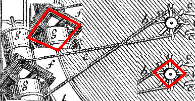

Your concern about the square pulley;
The screw is shown as being driven by a twisted rope belt on square pulleys. I have no idea why the pulleys were square. Square pulleys make no sense to me.
You know and I know that a 'V' or flat belt calls for the pulleys to be in alignment, they must 'track'. Even a flat belt pulley usually has a slight crown in it keeping the belt centered. My 48" belt sander is no different.
Look at the picture one more time, Please note that the screw pump is far from being aligned with the wheel axle in any direction. Thus the square pulleys, and they do make sense!
The rubbing or friction you speak of can only happen when the rope initially falls into or leaves the groove four times per revolution. This is even less noticeable on the forked wheel pulley. A round pulley out of alignment would rub constantly.
Not only are the square pulleys a viable solution for UN-alignment they also relieve the friction on the guide bearings by eliminating a belt tension-er which to my thinking would have increased the friction three-fold.

Posts: 7808
re: Speculations on the witness's evidence
So why are not all pulleys made square? It is much more effective to increase rope friction on the pulley by crossing the rope, but I can’t see any advantage to a square pulley. There is actually less surface area in the circumference of a square than a round pulley that was made the same diameter, making I would assume more prone to slippage. Ralph could very well be right that by adjusting the B holder he maximised surface contact on the square pulley, but look at the axle. What in the world stops the rope from slipping at the axle, it seems to have a very poor friction contact.
One wants as much friction as possible on the rope and as little friction as possible on the screw bearing and wheel axle bearings.
Post by Unbalanced »
There is more not less friction in a square pulley than a round one. Not to mention that a square pulley allows for UN-alignment of driver to driven or driven to driver.
A square pulley with crossed rope is making contact on all four corners. wrap a rope around a round object and pull it back and forth, note how much equal tension must be applied on both ends to prevent it from slipping.
Now try the same on a rectangle, size is of little importance and it can be smaller than the round version. You will find that less holding tension is required than on the round!
Unbalanced has joined the thread, being the nautical man that he is, I am sure that he is aware of the term 'Lay of the line or rope'. First, rope does not like sharp 90 degree bends, the friction of the rope slipping is ten-fold that of a round windlass. The flat or linear area of the square pulley is irrelevant and can be much shorter than the circumference of a round pulley.
I have seen many of deckhands get their ass chewed for mooring a line in a figure eight against the 'Lay' around a bollard cross bar.
I stand firm on my theory that Bessler used square pulleys mainly due to the UN-alignment of the wheel in relation to the screw pump.

path_finder
Posts: 2372
Location: Paris (France)
Post by path_finder »
IMHO the explanation of the square pulley is very simple:
If the rotation speed of the wheel is constant, and if you use some crimps forming a square frame (for a better transmission of the rope), you need on the other side a second square with the same size for the restitution of the primary constant speed (see the picture below).
For some reason they are not represented equal on the drawing.

daxwc wrote:So why are not all pulleys made square? It is much more effective to increase rope friction on the pulley by crossing the rope, but I can’t see any advantage to a square pulley.
Daxwc, if Bessler was requested to drive the water screw from either wheel rotation direction (it was a bi-direction wheel and he did say it could drive a load equally in either direction) then it may be that the rope was not always crossed.
I think Ralph's explanation for use of the square pulley is the most likely. If my 25 Watt power estimate for the water screw is correct then the relatively low torque required to turn the screw would limit problems with rope slippage.
Path_finder, rotation of the wheel/screw would be smoothed out by inertia of the system. The two square pulleys are not represented equal because it is a reduction drive. A reduction drive is often used to match drive power with an applied load.
Have you ever tried using a belt with pulleys or chain and sprocket on axles that are oblique to each other?
Crossed rope: is there an advantage to pumping water down the screw? If you reverse wheel direction, then to pump up you must change the belt configuration. The rope was not crossed for friction, but for direction.
Do you not see the lead-in and the lay-out advantage using a square pulley for an oblique angle.
