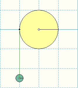

Ok Rainer, no problem. I give it a try from another viewpoint.
Ok, here is a screenshoot of a wm2d pulley, you taught me how to use.
As the circle rotates, the attachment point of the rope stays in position in the coordinate system, but the same time it goes around on the circumference of the circle, right?
What I would like is the reverse of this action:
The pulley stays motionless, and the attachment point (with the rope) go around on its circumference.
In the case of my earlier piston example,
I want to attach a rod (constant length), and make the attachment point go around while the circle stays motionless.
Check my earlier post & screenshot.
I can't do that, and I suppose it's not possible. Well, perhaps it has no use too... So, I am sorry to bothered you with this...
P.S. Drink a beer for my health, and laugh on it a big! ;-))

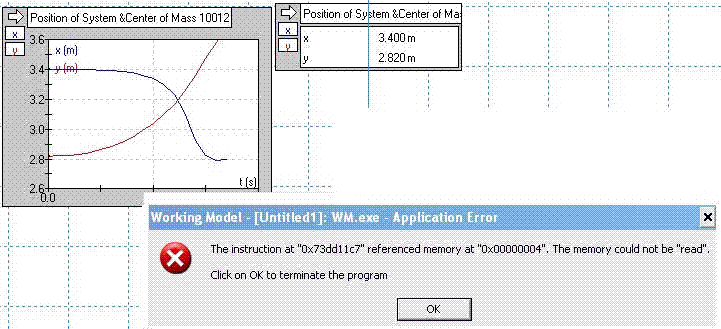

This sort of build isn't to see if you have a working wheel. What I'm speaking of is a build used to analyze a brief moment in time. wm2d draws some absurd results that might not be trustworthy.
Attached is a screen shot where in 3 brief seconds the system cog is at a point above where it began. The model doesn't begin 'wound' up.
