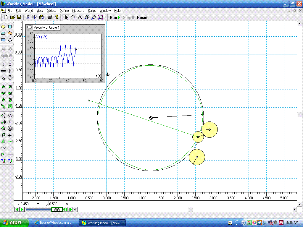

Hi All thanks for the input.
Stewart, I made the changes, thanks for the information
This model runs as 200 or 20.. It takes a couple of swings to gather momentum but it works.
Is this due to the program settings ?
Do I go with this whole phenomenon as a WM2D bug.
wheel- new constraints4.wm2d

Hey Dave, I like the concept....I found some of the components were starting with a charge on them. I zeroed those out and changed the air resistance to low...I find that a bit more realistic for this program. Here is a snap shot of how it ran after that. Took about 30 seconds to find that "rocking chair" motion many of us are all too familiar with. Thanks for sharing, Dave and welcome! Hope to hear more from you.
