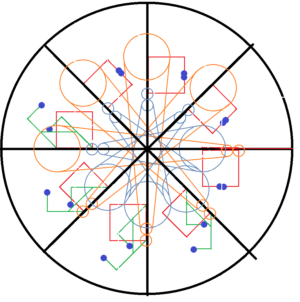

Where do I find the MT's again? I don't remember very clearly the toy page. This is what I drew out of the MT 138 clue from Bessler. I let the hammers fall on one side and I let them become a square again on the other side connected by gears so that they move their opposite sides in unison. A block on the right side might receive minimal resistance as the weights want to naturally fall into place on the right with some resistance on the left.

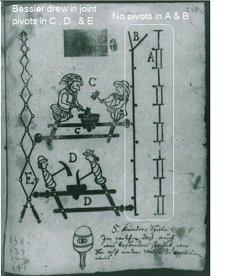

Comment .. B. took the care and effort to identify and include joint pivots in some of his TP woodcut toys, but not in others ..
The Hammermen toys C & D are operated by push and pull forces - however the pantograph frames are not pinned / pivoted to any background structure - they purely bring to our attention the PUSH and PULL forces ..
IF we were to pivot their pantograph frames to a background structure as I've indicated in the attachment ( O ) and assume that the majority of the toys mass is located at the heavy drum or wood chopping block, then the system GPE would rise to its highest position mid ' event ' and fall to lowest position at start and finish of one push or pull event ..
* I have drawn in an indicative GPE rise and fall track ( Yellow arc) for each toy should they be pivoted to the background as per my drawing - reminiscent of a swinging pendulum track only upside down ..
* Of course their pantograph frames are NOT pivoted ( pinned ) to any background in B's. TP woodcut, and my musings about pivoting them is to draw attention to a rising and falling of system GPE ..

I dont mean to be counter oppinion just for the sake of being so , but , i do see pivots drawn on A and B on the original scans .
But i mean if its symbolism then whether i see them may not even be important , its not like i know what was going on in besslers mind , im just poking physics stuff with a stick and see what happens .

“A” chain has holes but “B” chain I am not sure about.
It might be “B” chain the holes are in the other z plane.

In the “B” Chain if those are to be accurate pivots then it is not a Jacobs ladder. But if the pivots are drawn accurately then the very top of “B” doesn’t have an action like that. A Jacobs ladder needs a double hinge. If you mentally realise it is a "double hinge interpretation" then the action exists as well as a reason for the hand being cut away. Bessler became so paranoid you would recognise his biggest secret that he cut most of the hand away.

I tried to 4:1 ratio the drawing I made but there appears to be a ratchet conflict. I'm not familiar with ratchets. Is this a ratchet conflict that has been solved in other areas of mechanics already?
