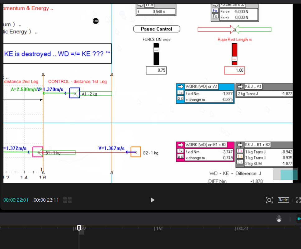

Here is what Copilot came up with the percentage difference:
n the last simulation, the Work Done (WD) was -5.391 Nm, and the Kinetic Energy (KE) was -3.514 J. To find the difference in Joules (J) as a percentage, we can use the formula:
In the last simulation, the Work Done (WD) was -5.391 Nm, and the Kinetic Energy (KE) was -3.514 J. To find the difference in Joules (J) as a percentage, we can use the formula:
Percentage Difference = ((WD - KE) / WD) * 100
Plugging in the values:
Percentage Difference = ((-5.391 - (-3.514)) / -5.391) * 100
Percentage Difference = (-1.877 / -5.391) * 100
Percentage Difference ≈ 34.81%
So, the difference in Joules in the last simulation is approximately 34.81%.

Okay second leg , you show work done does not equal the KE .
For the work energy theorem : W = Δ(KE) Work = Change(Delta) in Kinetic Energy , which is the difference of the initial Kinetic energy and the final Kinetic energy .
Leg 1 , the initial KE was 0 there was a change in KE of 3.380 and W done was 3.380 wich is correct since 3.380 - 0 = 3.380 .
Leg 2 , the final KE is 3.514 , and you show work done is 5.391 , so 1.877 difference .

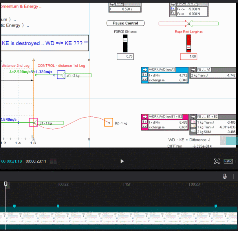

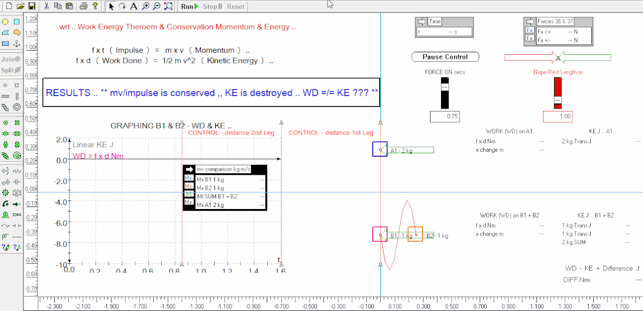

Here I redo the 'control vs ganged' experiment sim again - this time I labelled the distances the control travels during the 1st and 2nd legs of reversed impulse ( ft ) / momentum inputs - you can see visually and by the output tables that the horizontal distances are identical distances traveled for the 2 kg control .. also I added acceleration green vectors to the weights to make it easier too see the velocities are doubled for half the mass of the ganged sim B1 and that means the Momentum change is the same for both at any time interval etc .. I also halved the capture rate of the animation so I didn't have to zip around so fast in the time allowed which should be easier to follow ( can take a screen grab ) .. the 1st leg is split into ( paused at ) 2 parts as before - at 0.52 secs and again at 0.75 secs when the impulse / momentum given ceases - n.b. 2nd leg the impulse / momentum input is reversed as before but not shown in this animation ..
The sims have no frictions i.e. they are 'pure' experiments, with no friction energy losses to contact areas with slides, or air etc - but when the trailing B2 weight eventually collides with the B1 weight in leg 2 ( not shown in this animation grab ) they have elasticity set to 0.5 so there are energy losses at this stage due to deformation, synthesized heat and sound etc, of the objects etc - however this is AFTER the 1st leg we are examining here ..
The things imo of note is that the sims start from stationary i.e. have no momentum or energy .. in the 1st leg they are given an identical impulse ( f.t ) - iow's their momentums are changed by a consistent input of constant force x time - this is seen in the visuals and this time I did not include the output tables of the relative momentums ( at any time ) which are the same for both - however we can see that the ganged sim B1 has twice the acceleration of the A1 control, and twice the velocity, and twice the KE ( altho their momentum changes are the same ) - after the first pause at 0.52 secs the sim runs on to complete the 1st leg of impulse / momentum input .. at the instant the massless rope connecting B1 to B2 is tight the KE of B2 drops significantly ( see output tables ), and of course B2 gains momentum and KE - at this time momentum changes are still the same for both control and ganged experiment ..
When we look at the graphs of the ganged experiment we can visually see that up until the rope went taut the WD ( f.d ) was equal to the KE of B1 - after the rope goes taut the 2 ganged weights KE added together was substantially less ( 34% less ) than the WD on the system at the end of the 1st leg at 0.75 secs - we are missing 1.87 Nm ( J ) or energy ( it is literally Missing In Action ) ALTHO the Work was Done ( it was paid for ) !

It appears the discrepancy in your gif of the sim happens around 0.548 s (sim time) , up to that time everything is fine , i made a screen shot and recorded a gif so may see the exact moment.

The compared experiments are given a known and equal input of momentum change during leg 1 .. ** momentum change is the currency in the experiment to change movement ..
The sim is paused at 2 steps in leg 1 - at all times in leg 1 the linear momentums for both the control experiment and the comparison experiment are identical i.e. they both gain the same linear momentum .. see animation below which has a black output in the graph section comparing one above the other the momentums to time during the 1st leg ..
While and when the change to momentums is performed it is said that we can also at any time period calculate and predict the objects KE - thru the Work Energy Theorem we can calculate the Work Done ( f x d in N.m) and this will give us the objects subject to movement KE's in Joules ..
** Classical Physics is a circular referencing system i.e. if you know 1 or 2 things you can find one face or the other face of the same coin .. because it is a closed system, with circular referencing, it also means that the relationships between momentum changes to the system, Work Done on the system, and Energy changes to the system are not plastic or fluid i.e. they have perfect symmetry circling back to the conservation laws for momentum and energy ( and Newton's Laws ) ..
In this example the WD does not always equal the summed KE of B1 + B2 in the comparison experiment ( altho both received the same input of momentum change ) vividly shown after the rope is drawn taut and onwards to the 0.75 second mark ..

The point i was trying to make is it happens around the mark after the rope tightens , as for an explanation - i personally dont have an explanation which i can visually show , i changed the rope for a rod that becomes active when B1 reaches 0.7meters and the result is the same , my suspicion is it could be something that happens internally at the moment B1 starts tugging and onwards (The issue is i have no idea if thats true) .
