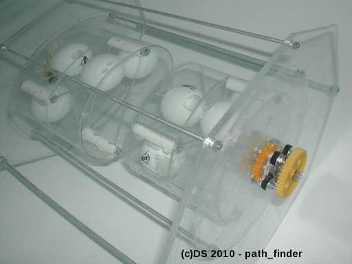

I associate myself with your pertinent idea, with this shot taken in my bathtub under the water in 2006.
The purpose of this test was to check if a negative gravity (in this case the Archimedes force) can give a different behaviour for a double Sommerset wheel.
The weights have been replaced by table-tennis 'ping-pong' balls.
Although the best quality of the bearings and of the balls (brand name Dunlop, the must), nothing can be deducted at all from this specially stupid experiment.
Nobody is perfect.
If you are patient I have some materials enough for the next 365 days.

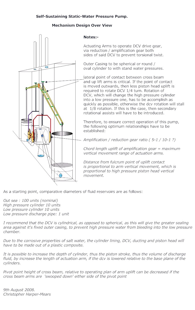

Although not a gravity wheel, I must ressurect for public viewing my variant of my device which tried to utilise deep water pressure.
The principle was:
High water pressure entered the inlet under the base, and force one of the pistons up.
This upwards movement, via a rocker, pushed another piston down. This low pressure water was forced up a central duct, with NRV's to prevent back pressure. This ejected high velocity water spun a turbine / generator.
As the rocker arm was rising, this lifted an actuation arm, which in turn, quickly rotated a directional control valve at the inlet.
So now the down piston compartment was pressurised with high pressure water, so it went up.
The other contain low pressure water which was ejected to the surface.
The space above the piston assys was open to atmospheric pressure, via the snorkels to the surface.
Right, who will start the bidding for this ingenious device ?
Do I hear $1.00.......
I have such a fondness for this stupid design :-)
Chris

Any successful bidder will receive this free single page instruction pamphlet !!!!!!!!!
Being a hydraulic's man, maybe Jim_Mich can let me know where it all went so 'orribly wrong with this concept ;-))

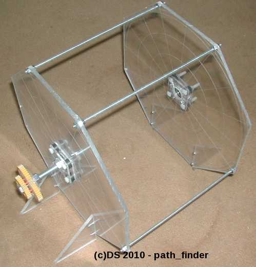

Another unsuccessful attempt of the same concept (two excentered Sommerset primemovers in phase opposition, like a pedalier) this time on the fresh air (forget the water and the Dunlop balls).
Even with marbles in uranium I suspect it will not work better.

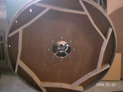

Variable Ramp Test Bed
I constructed this device to prove or disprove concepts using ramps.
The outer radius is constructed of a double layer of 1/8" tempered hardboard allowed to telescope. This ring is held in place by 'L' brackets which allows one to make any desirable eccentric desired.
The shown levers with Roller Blade wheels is of perforated flat bar and is guided by 1/8' X 1-1/8" flanged bearings giving the same effect as railroad car wheels riding on the track. The lever wheel assemblies weigh in at 2 pounds seven ounces and were all checked for exact weight per assembly. friction is held to a minimum.
No configuration of the ramp placement, how much out of eccentric, % of change or starting position, the outcome was always negative.
Therefore it is my conclusion that grounded ramps live up to their reputation as causing to much back-torque and drag.

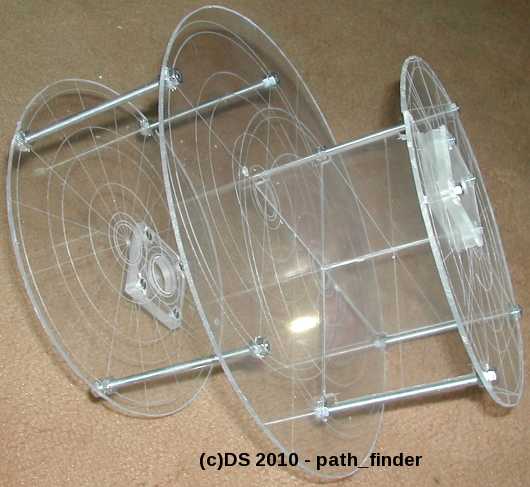

Another unsuccessful attempt.
This time there are two 'Sommerset like' primemovers, excentered in phase opposition, but instead to include some marbles in a quarter of disk, there are some doubled weights rolling inside an half circle shaped hole (four double weights in each primemover, located in quadrature).
In addition the shot shows a very common mistake: often some parts are mismounted, and you are obliged to redo the job.
That's the experience...

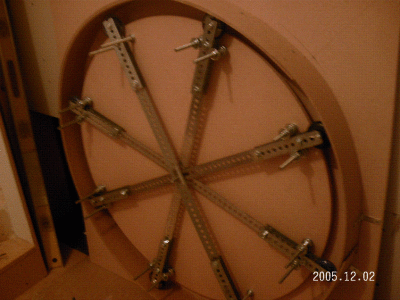

I found a picture of an old one I built before a had a computer. At the time I was building different types of wheels based on the two opposing triangles.In this desing I think I was trying to combine that with a swatsika type of lever. This was only the begining of my decent into madness. The problem with working with water is that as soon as you have one little leak you have to take everything apart and weight it all again. I discovered keeling before I knew what it was called.
I worked around this kind of design for about 2 years, then I got a laptop and found this site. Since then my builds have been a bit more Bessler inspired
